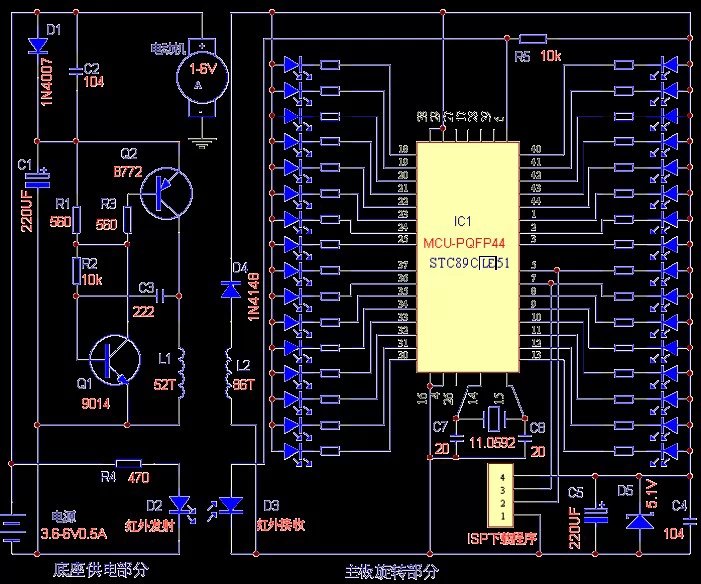

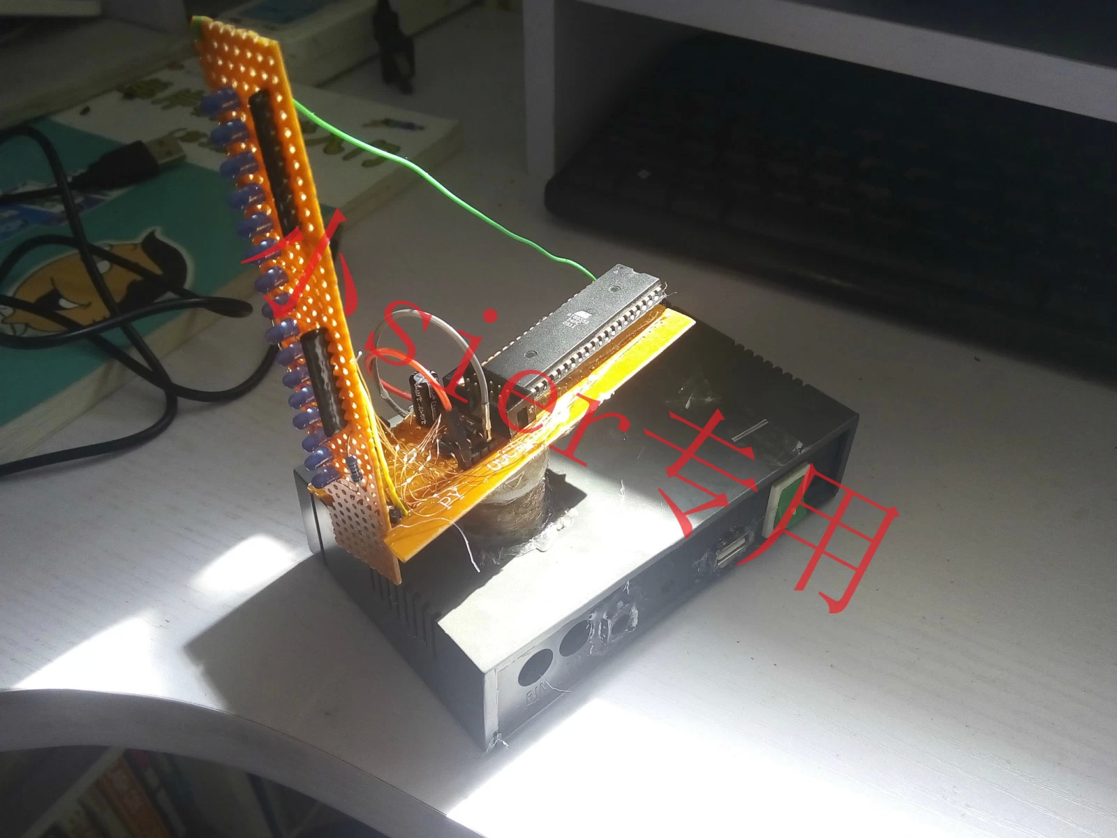

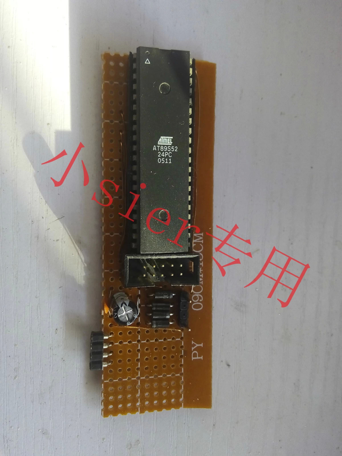

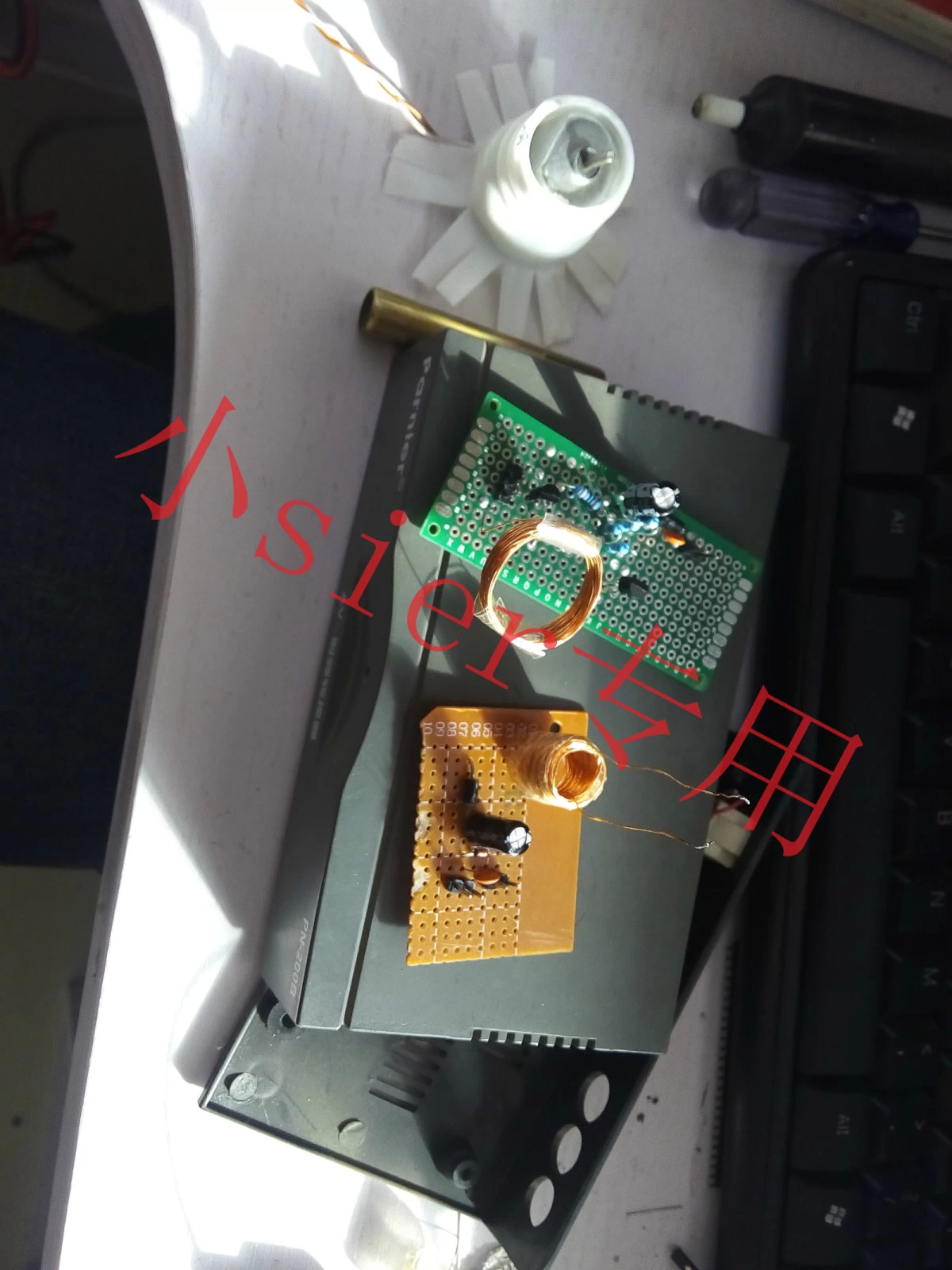

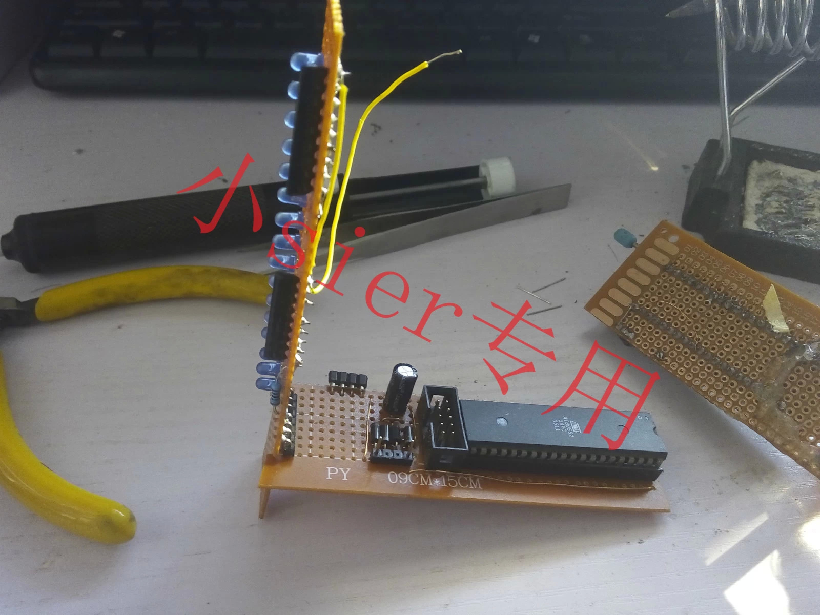

這個圖我改了一下   :    在接收線圈的整流電路  我用的是全橋整流,因為我用半波整流驅動不起來,損耗太大。還有就是電機要串上調壓電阻。以便不用改變程序的移位速度。還有最好用貼片    減輕其重量。
程序:
#include <AT89X52.h>
#define uchar unsigned char
#define uint unsigned int    //宏定義
sbit KEY=P3^2;
sbit led1=P1^1;
unsigned char code love[] = {
0xBF,0xFB,0xBB,0xFB,0xAB,0xFD,0xAB,0xFE,0x2B,0x01,0xAB,0x6D,0x8B,0x6D,0xA0,0x6D,0xAB,0x6D,0xAB,0x6D,0x2B,0x01,0xAB,0xFE,0xAB,0xFD,0xBB,0xFB,0xBF,0xFB,0xFF,0xFF,/*"春",0*/
0xFB,0xFF,0xBB,0xFF,0xBB,0xFF,0xBB,0xFF,0xA0,0xFF,0xBB,0xFF,0x3B,0x00,0xBB,0xFF,0xBB,0xFF,0xBB,0xF7,0xA0,0xEF,0xBB,0xF7,0x3B,0xF8,0xFB,0xFF,0xFB,0xFF,0xFF,0xFF,/*"節",1*/
0xFF,0xFE,0x1F,0xFF,0xFF,0xFF,0x00,0x00,0xEF,0xFF,0xDF,0x7E,0xF7,0xBE,0xF7,0xCE,0xF7,0xF2,0x00,0xFC,0xF7,0xF2,0xF7,0xCE,0x07,0xBE,0xFF,0x7E,0xFF,0x7E,0xFF,0xFF,/*"快",2*/
0xFF,0xFF,0xFF,0xDF,0x1F,0xEF,0x63,0xF7,0x7B,0xF9,0x7B,0xBF,0x7B,0x7F,0x0B,0x80,0x7D,0xFF,0x7D,0xFF,0x7C,0xFD,0x7D,0xFB,0x7F,0xF7,0x7F,0xCF,0xFF,0xFF,0xFF,0xFF,/*"樂",3*/
/*****n(us)延時子程序*****/
void DelayUs(uint N)
    uint x ;
    for(x=0;x<=N;x++);
/*****主函數*****/
void main(void)
    uint i=0,j=0 ;
    led1=0 ;
    //主程序中只檢測按鍵
    while(1)
        if(KEY==0)
            j++;
            if(j>740)
                j=0 ;
            for(i=j;i<30+j;i++)
                P0=love[i*2];
                P2=love[i*2+1];
                DelayUs(60);
                P0=0XFF;
                P2=0XFF;
/*****END*****/

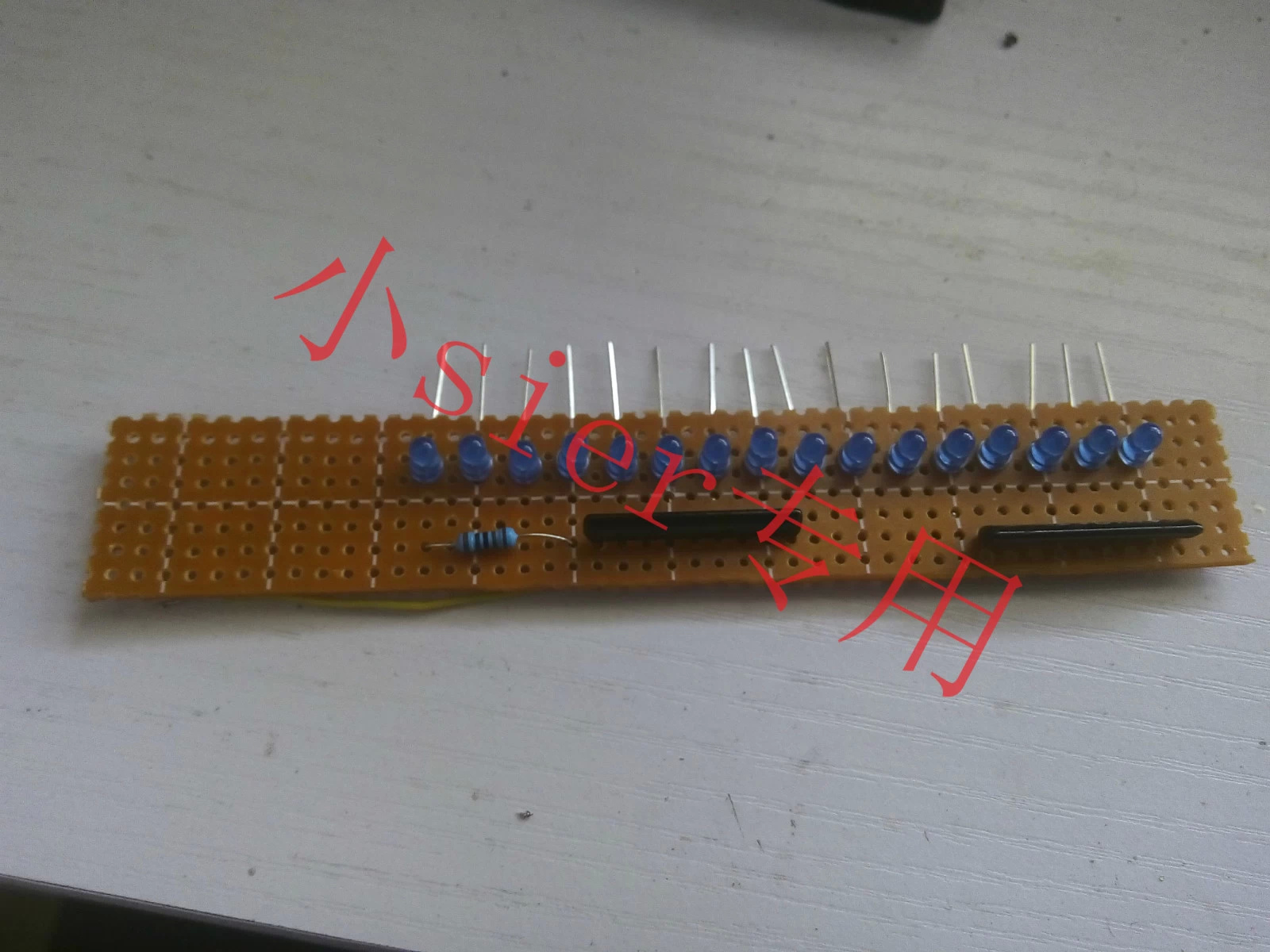

電路圖怎么這么多led?可你只用了十幾個,哪里可以省掉?對你這個很感興趣,可以交流一下嗎?微信tang1631

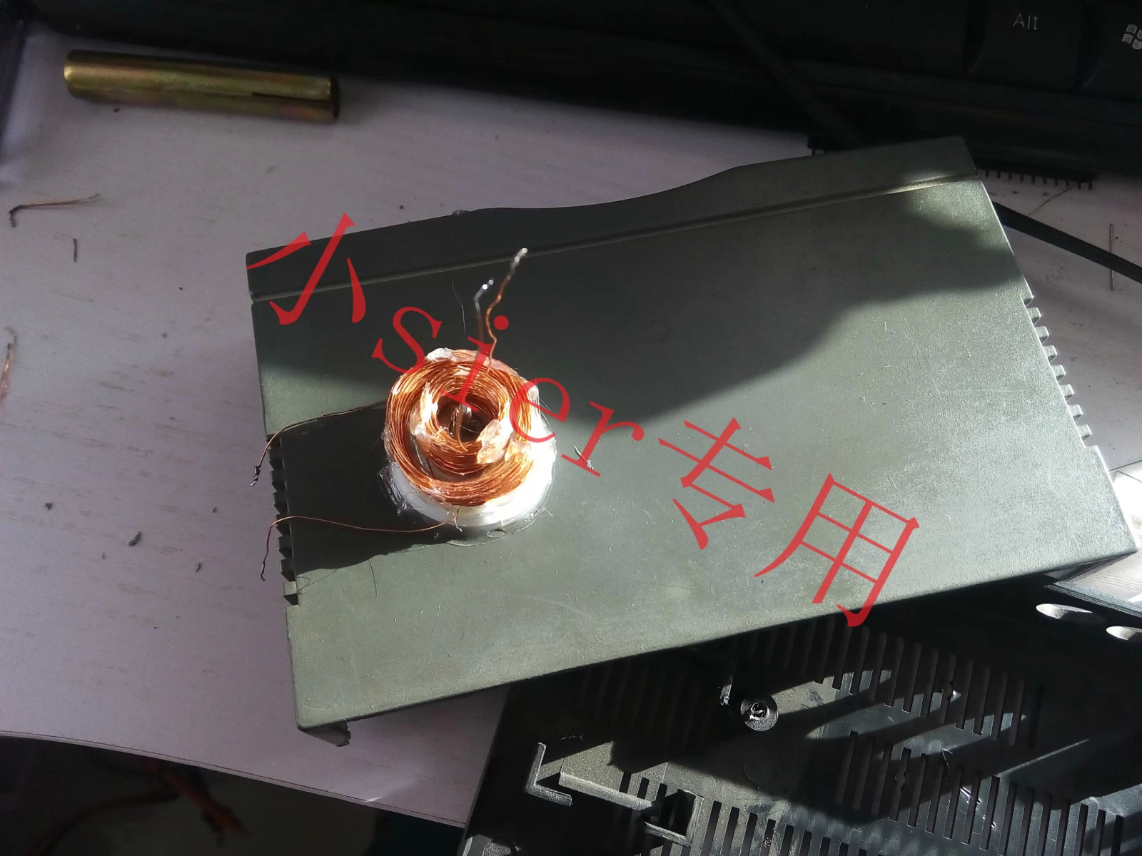

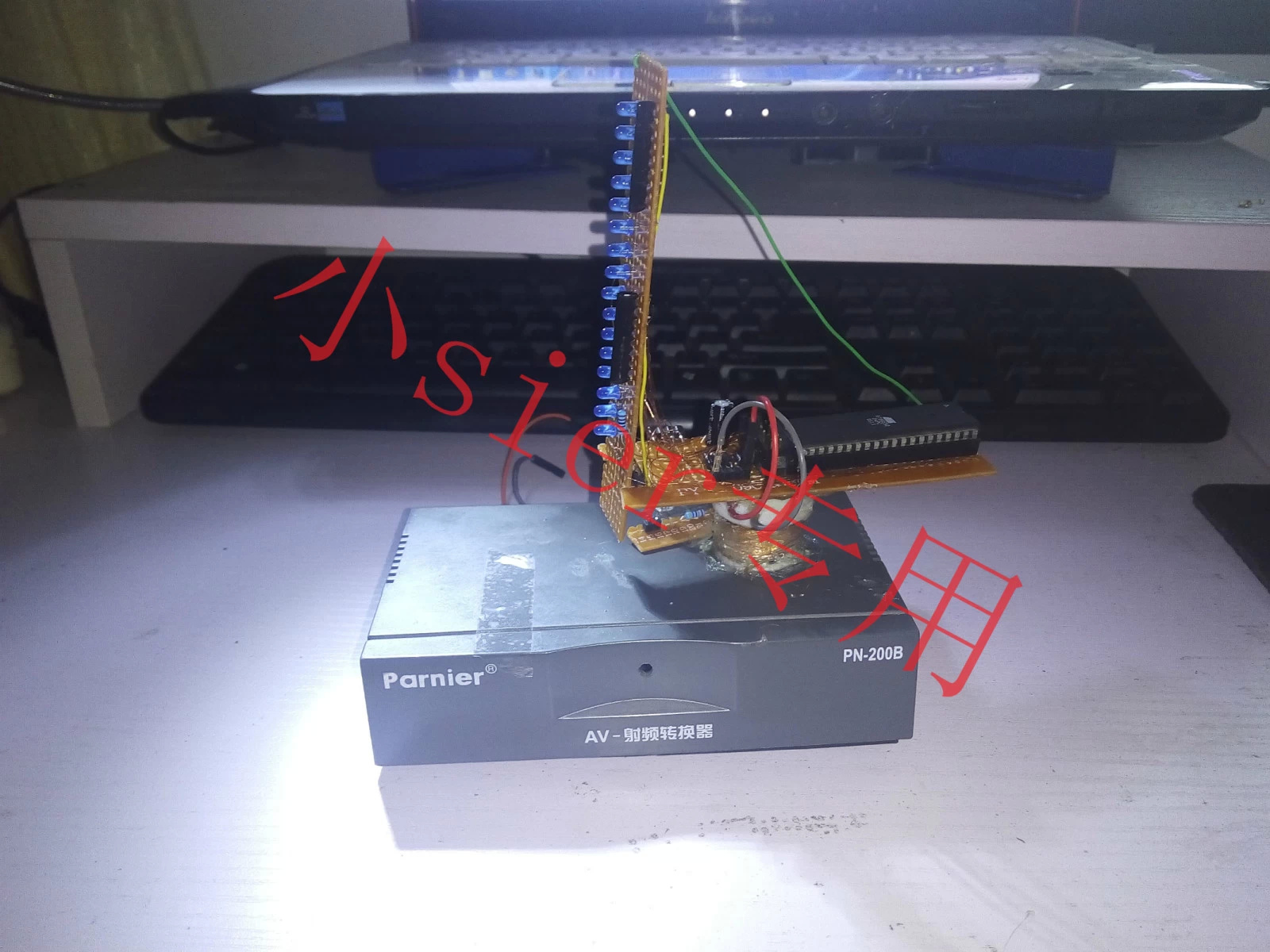

怎么轉起來的呀,自己繞的線圈嗎?

樓主平衡怎么做的呀?

無線供電部分 有什么特殊要求嗎?比如222的電容 瓷片電容可以嗎,線圈L的繞制  是采用多少線徑的漆包線呢,我弄得 無線供電 不能實現,不起振 是咋回事,希望能幫我下

你在原旋轉線圈--供電內圈內嵌入一磁環,其無線感應效率就提高了,不用全橋就可供電正常工作
