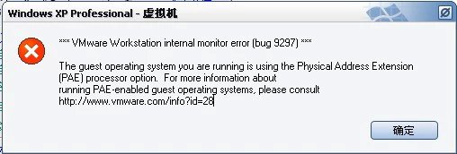

大概半個(gè)月前,我就從網(wǎng)上down了個(gè)漢化版的VMware Workstation 5.0,,打算裝個(gè)Windows Server 2003,從同學(xué)處借來(lái)光盤(pán)后,安裝過(guò)程中出了一些問(wèn)題,我也沒(méi)多想就沒(méi)裝了,直接裝到了電腦上的E盤(pán),我的電腦就成了雙系統(tǒng)了,,記得那時(shí)這個(gè)win 2003不能驅(qū)動(dòng)我的網(wǎng)卡,我為了驅(qū)動(dòng)它可費(fèi)了我的一番心血啊,那是笨啦!我的主板是華碩的,P5GC-MX/1333,不知道去生產(chǎn)商的網(wǎng)站去下 ,總算找了半天在個(gè)不知名的小網(wǎng)站找到了~~現(xiàn)在總結(jié)了一點(diǎn),那就是Windows Server 2003面向服務(wù)器的,它里面只集成了一些高性能的網(wǎng)卡的驅(qū)動(dòng)程序,我的垃圾網(wǎng)卡就驅(qū)動(dòng)不了 ,還有聲卡沒(méi)驅(qū)動(dòng),也挺費(fèi)勁了找到了一個(gè)萬(wàn)能聲卡驅(qū)動(dòng),AUD_ALLOS_XP_VISTA_5377_PV_REALTEK.EXE,閑話就不多說(shuō)了,今天我又下了個(gè)深度Windows XP SP3 完美精簡(jiǎn) v6.2 正式版來(lái)裝,結(jié)果中途有來(lái)問(wèn)題了,彈出個(gè)框框,我把它截圖了
還好我能看懂點(diǎn)英文,我按照它提示的一個(gè)網(wǎng)址www.vmware.com/info?id=28找到了答案,
Details
While I was trying to install a guest operating system, or upgrade an existing legacy virtual machine, my VMware product displayed a message that said the guest operating system was trying to use PAE. How can I correct the problem?
Solution
Below are two situations in which this error message appears:
- The host computer has a processor that includes NX (no execute) or XD (execute disable) technology, the host operating does not support the NX or XD bit, and the guest operating system makes use of the NX or XD bit. Affected guest operating systems include Windows XP SP2, Windows Server 2003, Red Hat Enterprise Linux 4, Red Hat Enterprise Linux 3 Update 3, and Solaris 10.
The NX technology is present in AMD processors including Athlon64, Opteron, and Sempron. The XD technology is present in Intel EMT64-capable processors. - You start a virtual machine created by VMware ESX Server, VMware GSX Server 2.0.1 or earlier, or VMware Workstation 3.x or earlier.
To resolve the issue:
- If you have a NX technology-enabled system, change or upgrade the host operating system to one that supports the NX or XD bit.
- If your host operating system is not PAE-enabled, but the guest is, power off the virtual machine and use a text editor to edit the VMX file (.vmx) for the affected virtual machine.
Search for a line beginning with:
paevm =
If the line appears, change it to:
paevm = "TRUE"
If the line does not exist, add it with the value of true as shown in the above example.
You can then power on the virtual machine and run a PAE enabled guest operating system in it.
For more information about editing the virtual machine's configuration file, see http://kb.vmware.com/kb/1714.
Note: If you run the Microsoft Application Compatibility Toolkit on a Windows XP Service Pack 1 system that has VMware Workstation 5 installed, the Application Compatibility Toolkit identifies Workstation as a program that has problems on Windows XP Service Pack 2. It identifies Workstation because of the issue described in this article. The workarounds described in this article resolve the issue.

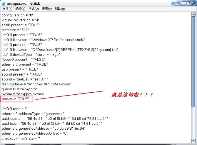

呵呵~我的問(wèn)題很簡(jiǎn)單,用搜索搜到我的winxppro.vmx,用記事本打開(kāi),在里面添上一句paevm = "TRUE",重啟OKay!!!!!!!!!!
