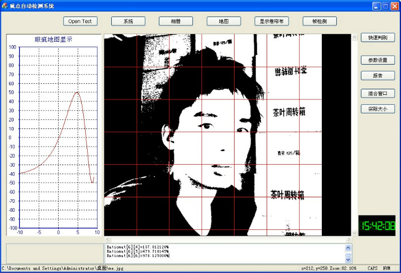

Freeimage的圖片切割分塊的處理。。。。尼瑪突然感到頭好暈。。。。。。。。。。。

//快速判別
void CStatintDlg::OnBnClickedDiscrimination()
if(m_kOrgImage.IsEmpty())  //there is no image we should exit from here
return;
size_t bpp = m_kOrgImage.GetBPP();
    if(1 == bpp) return;
m_kOrgImage.ConvertToGreyscale();
BYTE *lpBits = m_kOrgImage.GetBits();
    unsigned int width = m_kOrgImage.GetWidth();
unsigned int height = m_kOrgImage.GetHeight();
   m_Threshold = otsu(lpBits,height,width,0,0,width,height,0);
   TRACE1("otsu=%d\n\n",m_Threshold);
   ASSERT(m_Threshold >0 && m_Threshold < 256);
   unsigned int v = ( width - 1 ) / m_nBlockWidth + 1;
   unsigned int h = ( height - 1 ) / m_nBlockheight + 1;
  dMatrix Ratiomat(h,v);   //比列矩陣
  uMatrix BitMat(h,v);     //0-1矩陣
   long sFront,sBack;
   double fRatio;
   for(unsigned int j = 0; j < h; j ++ )
   for(unsigned int i = 0; i < v; i ++ )
   RECT rt;
   rt.left = i * m_nBlockWidth;
   rt.top = j * m_nBlockheight;
   rt.right = rt.left + m_nBlockWidth;
   rt.bottom = rt.top + m_nBlockheight;
   if( rt.right > (LONG)width ){
   rt.right = width;
   if( rt.bottom > (LONG)height ){
   rt.bottom = height;
   FIBITMAP* pCut = ::FreeImage_Copy( m_kOrgImage.GetHandle(), rt.left, rt.top, rt.right, rt.bottom );
    ::FreeImage_GetHistogram(pCut , m_hgray, FICC_RGB);
sFront = 0;
sBack = 0;
for (unsigned int k = 0;k<256;k++)
if(k > m_Threshold)
sFront += m_hgray[k];
else
sBack += m_hgray[k];
if(0 == sBack)   //防止處以0
fRatio = 1.0f;
else
    fRatio = (double)sFront/(double)sBack;
            Ratiomat[j] = fRatio;
if ( (abs(fRatio - m_fLowVal) > 1e-20 ) && (abs(fRatio - m_fHighVal) > 1e-20 ))
BitMat[j] = 1;
else
BitMat[j] = 0;
//舉例怎么取矩陣的值
TRACE3("Ratiomat[%d][%d]=%f%%\n",j,i,fRatio*100);
   if( pCut )
   ::FreeImage_DestroyICCProfile( pCut );
   m_kOrgImage.Threshold(m_Threshold);
   UpdateImage();
