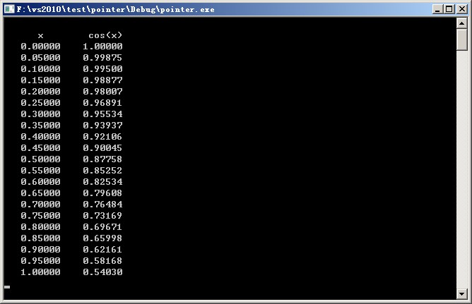

3、打印函數值,使用函數指針
#include <stdio.h>
#include <stdlib.h>
#include <math.h>
/* tabulates values of trigonometric functions */
void tabulate(double (*f)(double), double first, double last, double inc)
        double x;
        int i, num_intervals;
        num_intervals = ceil((last - first)/inc);
        for (i = 0; i<=num_intervals; i++)
                x = first + i*inc;
                printf("%10.5f %10.5f\n", x, (*f)(x));
int main(int argc, char *argv[])
        double initial = 0.0f,
                final = 1.0f,
                inc = 0.05f;
        printf("\n      x        cos(x)\n");
        tabulate(cos, initial, final, inc);
        getchar();
        return 0;
