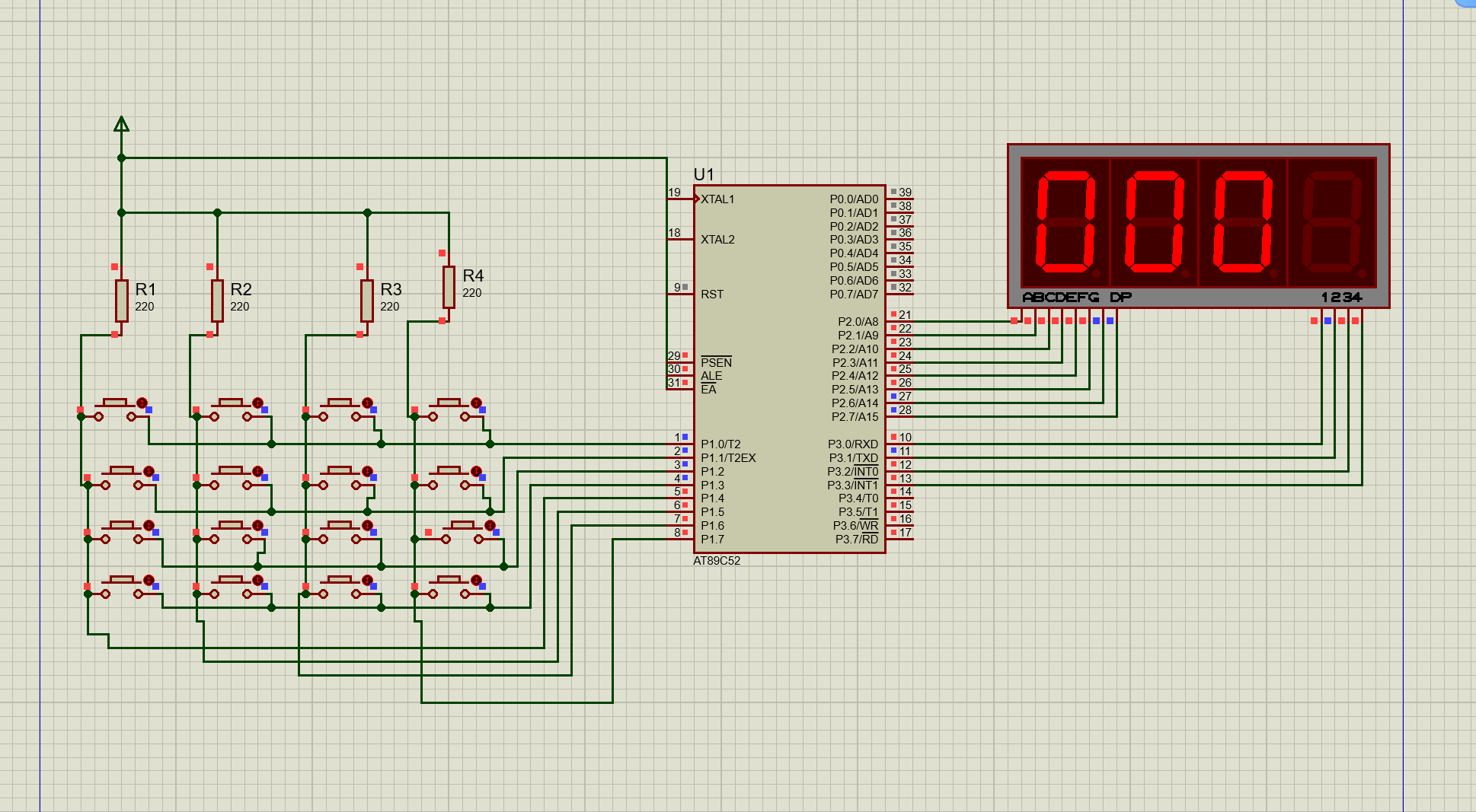

請問為什么我這個仿真圖的數碼管無論按哪個按鍵,都只顯示初始值呢
ID:1150590 發表于 2025-5-15 21:55 | 顯示全部樓層 |閱讀模式
#include <reg52.h>
#include <intrins.h>
#define uint unsigned int
#define uchar unsigned char
// ???????(P3.0-P3.2)
sbit WEI1 = P3^0;  // ?1?
sbit WEI2 = P3^1;  // ?2?
sbit WEI3 = P3^2;  // ?3?
// ????????(0-9)
uchar code seg_table[] = {
    0x3F, 0x06, 0x5B, 0x4F, 0x66,  // 0-4
    0x6D, 0x7D, 0x07, 0x7F, 0x6F   // 5-9
uint key, key_num;  // ?????
void delay_1ms(uint x)
    TMOD = 0x01;    // ???0??1
    TR0 = 1;        // ?????
    while(x--)
        TH0 = 0xFC; // 1ms????
        TL0 = 0x18;
        while(!TF0); // ????
        TF0 = 0;
    TR0 = 0;        // ?????
void display(uint num)
    static uchar pos = 0; // ??????
    uchar digits[3];      // ?????????
    digits[0] = num / 100;         // ??
    digits[1] = (num / 10) % 10;   // ??
    digits[2] = num % 10;           // ??
    WEI1 = WEI2 = WEI3 = 1;
    switch(pos)
        case 0:
            P2 = seg_table[digits[0]];
            WEI1 = 0;
            break;
        case 1:
            P2 = seg_table[digits[1]];
            WEI2 = 0;
            break;
        case 2:
            P2 = seg_table[digits[2]];
            WEI3 = 0;
            break;
    pos = (pos+1) % 3;  // ????
    delay_1ms(2);       // ?????2ms
uchar keyscan()
    uchar i, j, key_value = 0xFF;
    P1 = 0xF0; // ?4???0,?4???1
    if(P1 != 0xF0) { // ?????????
        delay_1ms(10); // ??
        if(P1 != 0xF0) {
            for(i = 0; i < 4; i++) {
                P1 = ~(0x01 << i); // ???????
                for(j = 0; j < 4; j++) {
                    if(!(P1 & (0x10 << j))) { // ???
                        key_value = i * 4 + j; // ????
                        while(P1 != 0xF0); // ??????
                        return key_value;
    return key_value;
void keynum()
    uchar i, j;
    uchar code tab[4][4] = {
        {'7', '8', '9', '/'},
        {'4', '5', '6', '*'},
        {'1', '2', '3', '-'},
        {'C', '0', '=', '+'}
    key = keyscan();
    if(key != 0xFF)
        i = key / 4;  // ??
        j = key % 4;  // ??
        key_num = tab[i][j] - '0'; // ???????0-9
void main()
    uint square_value = 0;
    P3 = 0xFF;  // ?????
    while(1)
        keynum();  // ????
        if(key != 0xFF)
            if(key_num >= 0 && key_num <= 9) {
                square_value = key_num * key_num;  // ?????
        display(square_value);  // ??????
仿真圖
仿真圖
ID:712097 發表于 2025-5-16 15:03 | 顯示全部樓層
硬件電路不對,MCU端口不足以驅動4位數碼。需要加三極管/MOS/反相器/緩沖器/專用數碼管驅動IC等。
ID:996773 發表于 2025-5-16 15:32 | 顯示全部樓層
位選1234要用四個三極管擴流供電,52的單片機io口上拉電流很弱,樓主的模電很弱所以不理解,還得多修煉
ID:1109793 發表于 2025-5-16 15:44 | 顯示全部樓層
數碼管驅動是可以的,前提是把IO設置推挽模式,另外段碼腳要加個限流電阻的。但是你這標準C51可能不行。
矩陣按鍵不是有個反轉法嗎?論壇里搜一下
