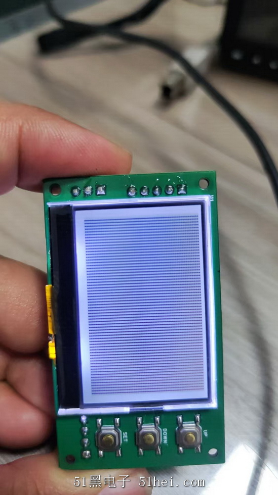

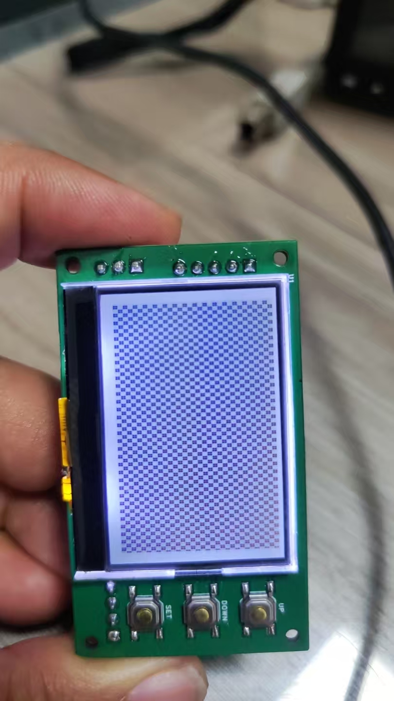

單片機LCD ST7567驅動程序
ID:848270 發表于 2020-11-24 11:03 | 顯示全部樓層 |閱讀模式
#include<reg52.h>
#include<intrins.h>
#define uchar  unsigned char
#define uint   unsigned int
#define delayNOP(); {_nop_();_nop_();_nop_();_nop_();};
sbit RET = P3^1;  //復位端
sbit CS  = P3^2;  //片選端
sbit RS  = P3^0;  //顯示數據或控制指令
sbit SID = P1^1;  //數據輸入端/
sbit CLK = P1^0;  //同步時鐘
//sbit P3_2=P3^2;  //int0
//unsigned char flag,page;
uchar code bmp1[];
uchar code bmp2[];
void delay1(uint t)  //1ms
    unsigned int i,j;
    for(j=0;j<t;j++)
    for(i=0;i<125;i++);
void delay2(uint ms) //1ms帶中斷
   uint i,j;
    for(i=0;i<ms;i++)
   for(j=0;j<125;j++);
// while(flag==0);
void int0() interrupt 0 using 0
    unsigned int a;
    for(a=0;a<2500;a++);
    if(P3_2==0)
      for(a=0;a<2500;a++);//10ms
      flag=1-flag;
   while(P3_2==0);
      while(P3_2==0);
return;
void sendcmd(uchar dat)///串行傳送一字節數據
      uchar i;
      for (i=0;i<8;i++)
          if ((dat&0x80)!=0)
          SID = 1;
          else
          SID = 0;
          CLK = 1;
          CLK = 0;
          dat = dat<<1;
void send(bit i)
    SID=i;
delayNOP();
CLK=1;
delayNOP();
CLK=0;
delayNOP();
CLK=1;
   uchar i;
   for(i=0;i<8;i++)
        if((dat&0x80)==0x80)
        send(1);
      else
        send(0);
        dat=dat<<1;
void trancmd(uchar cmdcode)
   CS=0;
   RS=0;
   sendcmd(cmdcode);
   CS=1;
void trandata(uchar dat1)
   CS=0;
   RS=1;
   sendcmd(dat1);
   CS=1;
void disp_bmp(uchar *sp)//顯示一幅128*64的圖片
    uchar i,j;
     for(i=0xb0;i<0xb8;i++)
        ;trancmd(0xa6);
        trancmd(i);
        trancmd(0x10);
        trancmd(0x0);
        for(j=0;j<129;j++)
        trandata(*sp++);
void bdisp_all(uint x,uint y)  //帶
        uint i,j,t;
        ;trancmd(0xa6);
        trancmd(0xb0);    //寫頁地址
        trancmd(0x10); //寫初始列地址
        trancmd(0x0);
        trandata(0x0);
        for(j=0;j<128;j++) //j<64;是一樣的
         trandata(x); //寫顯示數據
       for(i=0xb1;i<0xb8;i++)
        ;trancmd(0xa6);
        trancmd(i);
        trancmd(0x0);
        trandata(0x0);
        for(t=0;t<128;t++)
         trandata(y); //寫顯示數據
       trancmd(0x40);
       delayNOP();
       delay2(500);
       trancmd(0x60);
       delayNOP();
void disp_all(uint x1,uint y1,uint x2,uint y2,uint x3,uint y3,uint x4,uint y4)  //帶
    unsigned int i=0,j=0;
        ;trancmd(0xa6);
        trancmd(i);    //寫頁地址
        trancmd(0x0);
        trandata(0x0);
        for(j=0;j<16;j++) //j<64;是一樣的
         trandata(x1); //寫顯示數據
         trandata(y1);
         trandata(x2); //寫顯示數據
         trandata(y2);
         trandata(x3); //寫顯示數據
         trandata(y3);
         trandata(x4); //寫顯示數據
         trandata(y4);
void initlcd()
  trancmd(0xe2); //reset
  trancmd(0xa3); //LCD BIAS=1/9行寫入數據地址加1,但讀入不加
  trancmd(0xa0); //列地址移動方向:ADC=0(SEG1->SEG132)
  trancmd(0xc8); //行掃描方向:SHL=1(COM64->COM1)
  trancmd(0x2c); //VC ON
  delayNOP();
  trancmd(0x2e); //VR ON
  delayNOP();
  trancmd(0x2f); //電源控制模式:VC,VR,VF=111
  delayNOP();
  trancmd(0x81); //對比度寄存器模式
  delayNOP();
  trancmd(0x31); //對比度調整
  delayNOP();
  trancmd(0x23); //設置電阻分壓
  delayNOP();
  trancmd(0xaf); //開顯示
  delayNOP();
  trancmd(0x60); //起始行com33
  delayNOP();
void main()
     //IE=0;
    // P3_2=1;
// EA=1;
// EX0=1;
// IT0=1;   //下降沿觸發
// flag=1;
  delay1(50);
     RET=0;
     delay1(50);
     RET=1;
  initlcd();     //初始化
     delay1(50);
  while(1)
      disp_bmp(bmp1);   //圖片1
      delay2(600);
      disp_bmp(bmp2);  //圖片2
      delay2(600);
      disp_all(0xcc,0xcc,0x33,0x33,0xcc,0xcc,0x33,0x33);   //米
      delay2(600);
      disp_all(0x33,0x33,0xcc,0xcc,0x33,0x33,0xcc,0xcc);   //米
      delay2(600);
   disp_all(0xff,0xff,0xff,0xff,0xff,0xff,0xff,0xff);   //全顯
      delay2(600);
      bdisp_all(0xfe,0xff);       //全顯少一橫
      delay2(600);
      disp_all(0xaa,0xaa,0xaa,0xaa,0xaa,0xaa,0xaa,0xaa);     //橫
      delay2(600);
      disp_all(0x55,0x55,0x55,0x55,0x55,0x55,0x55,0x55);  //橫
      delay2(600);
      disp_all(0xff,0x00,0xff,0x00,0xff,0x00,0xff,0x00);   //豎
      delay2(600);
      disp_all(0x00,0xff,0x00,0xff,0x00,0xff,0x00,0xff);    //豎
      delay2(600);
      disp_all(0x00,0x00,0x00,0x00,0x00,0x00,0x00,0x00);    //空白
      delay2(400);

剛買了一片ST7567的12864屏,用賣家提供的程序測試后,又順便測試了一下樓主的程序,只修改了端口,編譯下載,竟然可用!

你好,請教一下,我用這個驅動可以顯示,就是對比度明顯不對,要怎么調呢
ID:151400 發表于 2023-5-26 14:17 | 顯示全部樓層
hahx2008 發表于 2023-5-26 13:47
初始化里不是有調節對比度的指令么?
ID:603478 發表于 2023-5-26 14:36 | 顯示全部樓層
hnsdyhj 發表于 2023-5-26 14:17
初始化里不是有調節對比度的指令么?
是改變這個值嗎,試了好像沒有變化。
同一個屏,在arduino里面可以調對比度,stc51不太熟悉。
