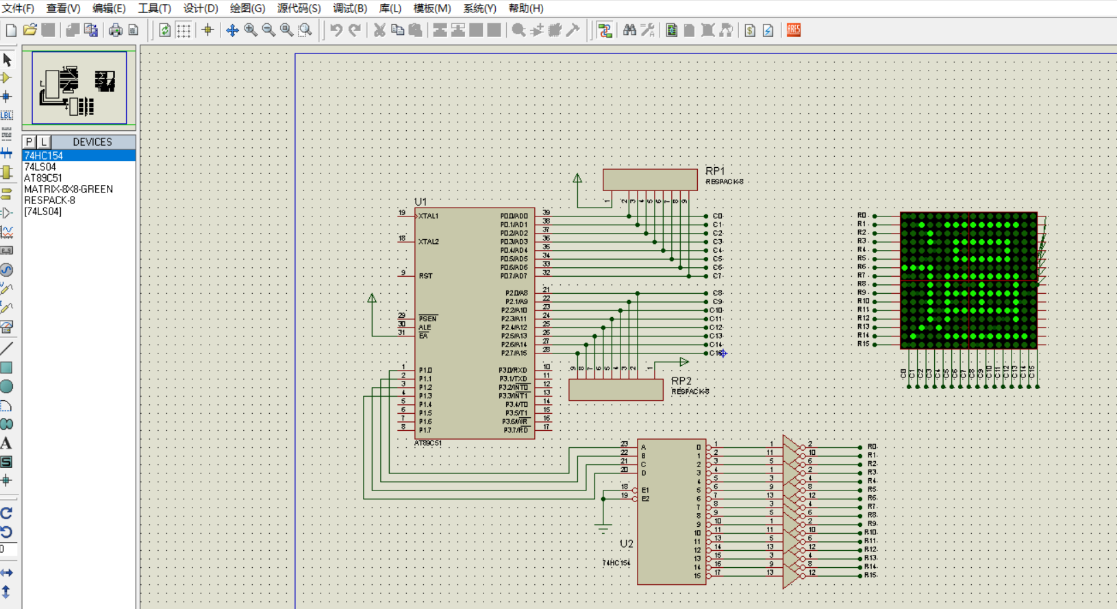

89c51 16x16led循環(huán)顯示漢字程序
跳轉(zhuǎn)到指定樓層
  1. #include <reg51.h>
  3. #define uint unsigned int
  4. #define out0 P0
  5. #define out2 P2
  6. #define out1 P1
  7. void delay (uint j)
  8. {
  9.   uchar i=250;
  10.   for(;j>0;j--)
  11.   {
  12.    while (--i);
  13.    }
  14.   }
  15.   uchar code string[]={
  16. 0xEF,0xFD,0xEF,0xFE,0x2F,0xC0,0xB7,0xD6,0xB7,0xD9,0xB3,0xD6,0x33,0xC0,0xF5,0xF6,
  17. 0x76,0xEF,0xB7,0xDE,0xD7,0xA0,0x77,0xEF,0xB7,0xF6,0xF7,0xF9,0x77,0xE6,0x97,0x9F,
  18. 0xFF,0xFF,0x1B,0xC0,0xF7,0xFF,0x37,0xE0,0xBF,0xEF,0x3F,0xE0,0xF0,0xFF,0x17,0xC0,
  19. 0xD7,0xDD,0x17,0xC0,0xD7,0xDD,0x17,0xC0,0xD7,0xDF,0xEB,0xFF,0x1D,0x80,0xFF,0xFF,
  20.   };
  21. void main()
  22. {
  23.    uchar i,j,n;
  24.    while(1)
  25.    {
  26.      for(j=0;j<2;j++)
  27.      {
  28.             for(n=0;n<40;n++)
  29.        {
  30.                for(i=0;i<16;i++)
  31.                 {
  32.                       out1=i%16;
  33.                       out0=string[i*2+j*32];
  34.                       out2=string[i*2+1+j*32];
  35.                       delay(2);
  36.                       out0=0xff;
  37.                       out2=0xff;
  38.                 }
  39.               }
  40.             }
  41.           }
  42.   }
