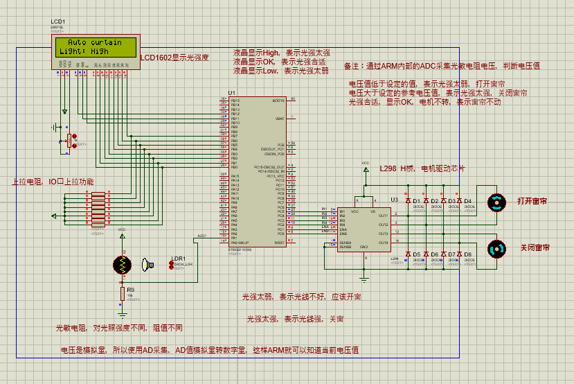

基于stm32的智能窗簾Proteus仿真設計
ID:511094 發(fā)表于 2020-3-27 13:10 | 顯示全部樓層 |閱讀模式

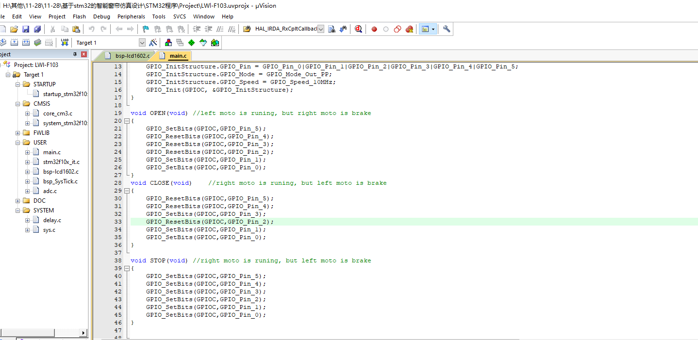

單片機源程序如下:
  1. #include "stm32f10x.h"
  2. #include "bsp-lcd1602.h"
  3. #include "delay.h"
  4. #include "sys.h"
  5. #include "adc.h"
  6. void L298_GPIO( void )
  7. {
  8.         GPIO_InitTypeDef GPIO_InitStructure;
  9.
  10.         RCC_APB2PeriphClockCmd(RCC_APB2Periph_GPIOC, ENABLE);
  11.         GPIO_InitStructure.GPIO_Pin = GPIO_Pin_0|GPIO_Pin_1|GPIO_Pin_2|GPIO_Pin_3|GPIO_Pin_4|GPIO_Pin_5;
  12.         GPIO_InitStructure.GPIO_Mode = GPIO_Mode_Out_PP;
  13.         GPIO_InitStructure.GPIO_Speed = GPIO_Speed_10MHz;
  14.         GPIO_Init(GPIOC, &GPIO_InitStructure);
  15. }
  16. void OPEN(void)        //left moto is runing, but right moto is brake
  17. {
  18.         GPIO_SetBits(GPIOC,GPIO_Pin_5);
  19.         GPIO_ResetBits(GPIOC,GPIO_Pin_4);
  20.         GPIO_ResetBits(GPIOC,GPIO_Pin_3);
  21.         GPIO_ResetBits(GPIOC,GPIO_Pin_2);
  22.         GPIO_SetBits(GPIOC,GPIO_Pin_1);
  23.         GPIO_SetBits(GPIOC,GPIO_Pin_0);
  24. }
  25. void CLOSE(void)        //right moto is runing, but left moto is brake
  26. {
  27.         GPIO_ResetBits(GPIOC,GPIO_Pin_5);
  28.         GPIO_ResetBits(GPIOC,GPIO_Pin_4);
  29.         GPIO_SetBits(GPIOC,GPIO_Pin_3);
  30.         GPIO_ResetBits(GPIOC,GPIO_Pin_2);
  31.         GPIO_SetBits(GPIOC,GPIO_Pin_1);
  32.         GPIO_SetBits(GPIOC,GPIO_Pin_0);
  33. }
  34. void STOP(void)        //right moto is runing, but left moto is brake
  35. {
  36.         GPIO_SetBits(GPIOC,GPIO_Pin_5);
  37.         GPIO_SetBits(GPIOC,GPIO_Pin_4);
  38.         GPIO_SetBits(GPIOC,GPIO_Pin_3);
  39.         GPIO_SetBits(GPIOC,GPIO_Pin_2);
  40.         GPIO_SetBits(GPIOC,GPIO_Pin_1);
  41.         GPIO_SetBits(GPIOC,GPIO_Pin_0);
  42. }
  43. int main(void)
  44. {
  45. int a,b,c,d;
  46.         float temp;
  47.
  48.         delay_init();                     //延時函數(shù)初始化
  49.         LCD1602_Init();
  50.     ADC1_GPIO_Config();
  51.         L298_GPIO();
  52.     ADC_Config();
  53.         LCD1602_ShowStr(0,0,"  Auto curtain ",15);
  54.         LCD1602_ShowStr(0,1,"Light:",6);
  55.
  56.         while(1)
  57.         {
  58.                 b=ADC_GetConversionValue(ADC1);
  59.                 temp=b*(3.4/4096)*10;
  60.                 //表示光線太弱
  61.                 if( temp < 8 )
  62.                 {
  63.                         LCD1602_ShowStr(7,1,"Low ",4);
  64.                         OPEN();
  65.                 }
  66.                 else
  67.                 {
  68.                         if( temp < 25)                                //光線合適
  69.                         {
  70.                                 LCD1602_ShowStr(7,1,"OK  ",4);
  71.                                 STOP();
  72.                         }
  73.                         else                                                //光線太強
  74.                         {
  75.                                 LCD1602_ShowStr(7,1,"High",4);
  76.                                 CLOSE();
  77.                         }
  78.                 }
  79. //                a=temp/1;
  80. //                c=temp*10;
  81. //                d=c%10;
  82. //                LCD_ShowNum(11,0,a);
  83. //                LCD_ShowNum(13,0,d);
  84.         }
  85. }

ID:724710 發(fā)表于 2020-4-27 10:31 | 顯示全部樓層
原理圖顯示有錯誤,控制距離遠近顯示屏有時不變化,相應的電機不轉動
ID:368810 發(fā)表于 2020-5-20 10:36 | 顯示全部樓層
樓主,程序那個文件夾里哪個是主程序啊,用什么軟件打開?

ID:772082 發(fā)表于 2020-6-15 11:59 | 顯示全部樓層
zyy1100 發(fā)表于 2020-5-20 10:36
keil v5 mdk可以打開
ID:780927 發(fā)表于 2020-6-16 14:59 | 顯示全部樓層
請問有電路原理圖嗎?
