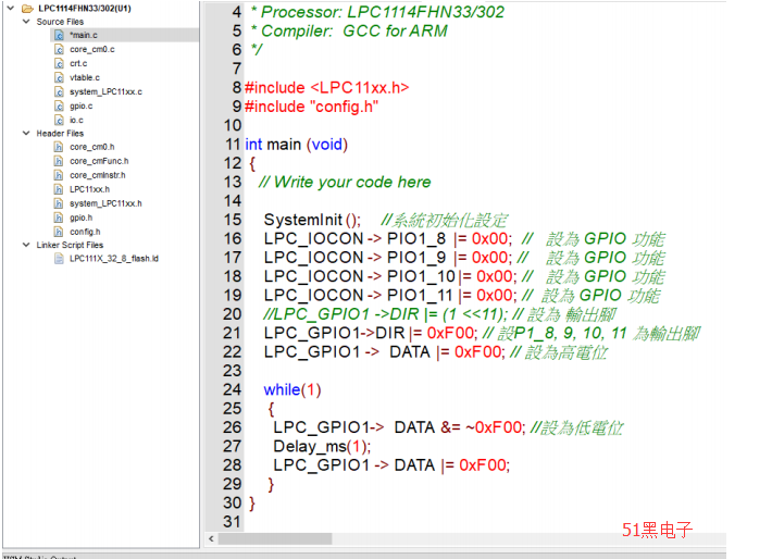

Here, I just like to share the experience about how to use Protesu 8 to run LPC1114. The difficult part of the exercise is to add c-source and header file and how to make .h and .c file link with Proteus complier. After modifiing some contents in those files, it can be compliered successful. I hope this simple document can be helpful for entry-level people who wants to learn LPC1114. Cheer up!!
Proteus Exercise 1

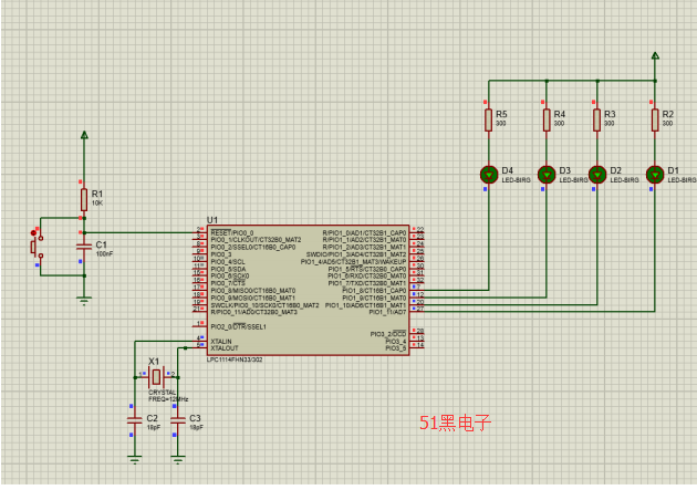

Purpose : Learn how to use LPC1114 to control LEDs turn on and off between interval
of 1 min. second.
LED turn OFF
LED turn ON
Result of Complier: Success!!
