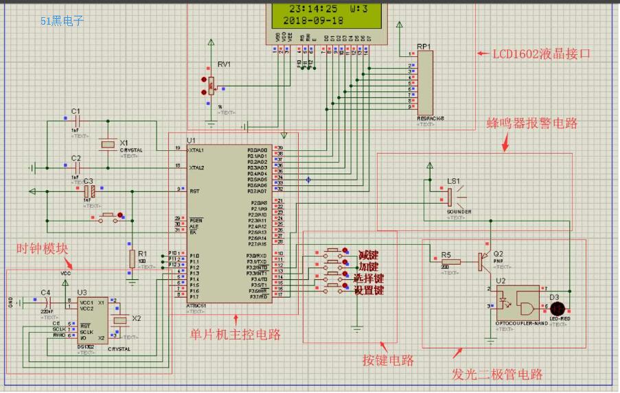

基于51單片機(jī)的定時(shí)插座程序+電路設(shè)計(jì)

程序 #include<reg52.h>#define uchar unsigned char#define uint unsigned intsbit lcdrs=P3^7;sbit lcdrw=P3^6;sbit lcden=P3^5;sbit inf=P3^3;sbit SCLK=P0^7;sbit  IO=P0^6; sbit RST=P0^5 ...

程序和仿真圖全部對(duì)不上,IO口沒(méi)一個(gè)匹配的
ID:378915 發(fā)表于 2020-12-2 15:44
樓主,這程序我運(yùn)行不正常,你Q嗎,請(qǐng)教下問(wèn)題。謝謝
