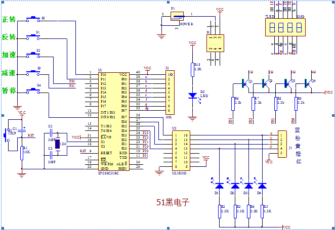

51單片機(jī)控制步進(jìn)電機(jī)按鍵操作程序+電路

電路原理圖如下: #include<reg51.h> #define uchar unsigned char #define uint unsigned int #define led P0 #define haha P2 sbit s1 = P1^0; sbit s2 = P1^1; sbit s3 = P3^0; sbit s4 = P3^ ...

原理圖發(fā)了和沒(méi)發(fā)一樣
